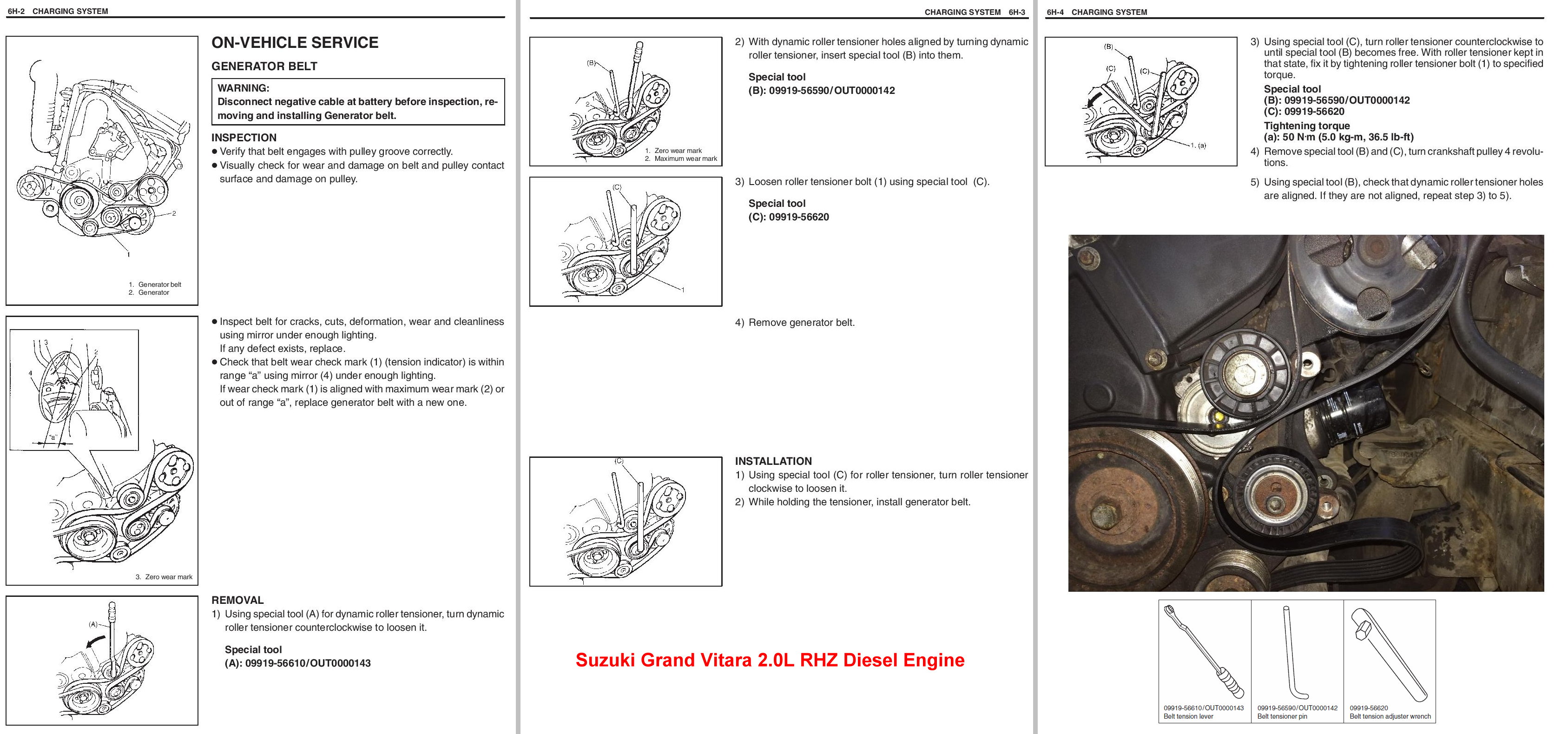

So, on my MOT I was advised that the serpentine belt ( I know it as the generator belt but I guess they know) needs changing.
Does anyone know the length of the belt at all?
I've found a picture of the belt routing for a petrol engine, does anyone know if it's much different for the 2.0TD engine please?

Re: Belt replacement 2.0TD Grand Vitara
Post by Darrell » Mon Jul 20, 2015 10:38 pm
I have this in my collection of diagrams :thumbup:
I don't think the special tools are very special..
RHZ Alternator belt fitting.jpg (790.55 KiB) Viewed 12307 times

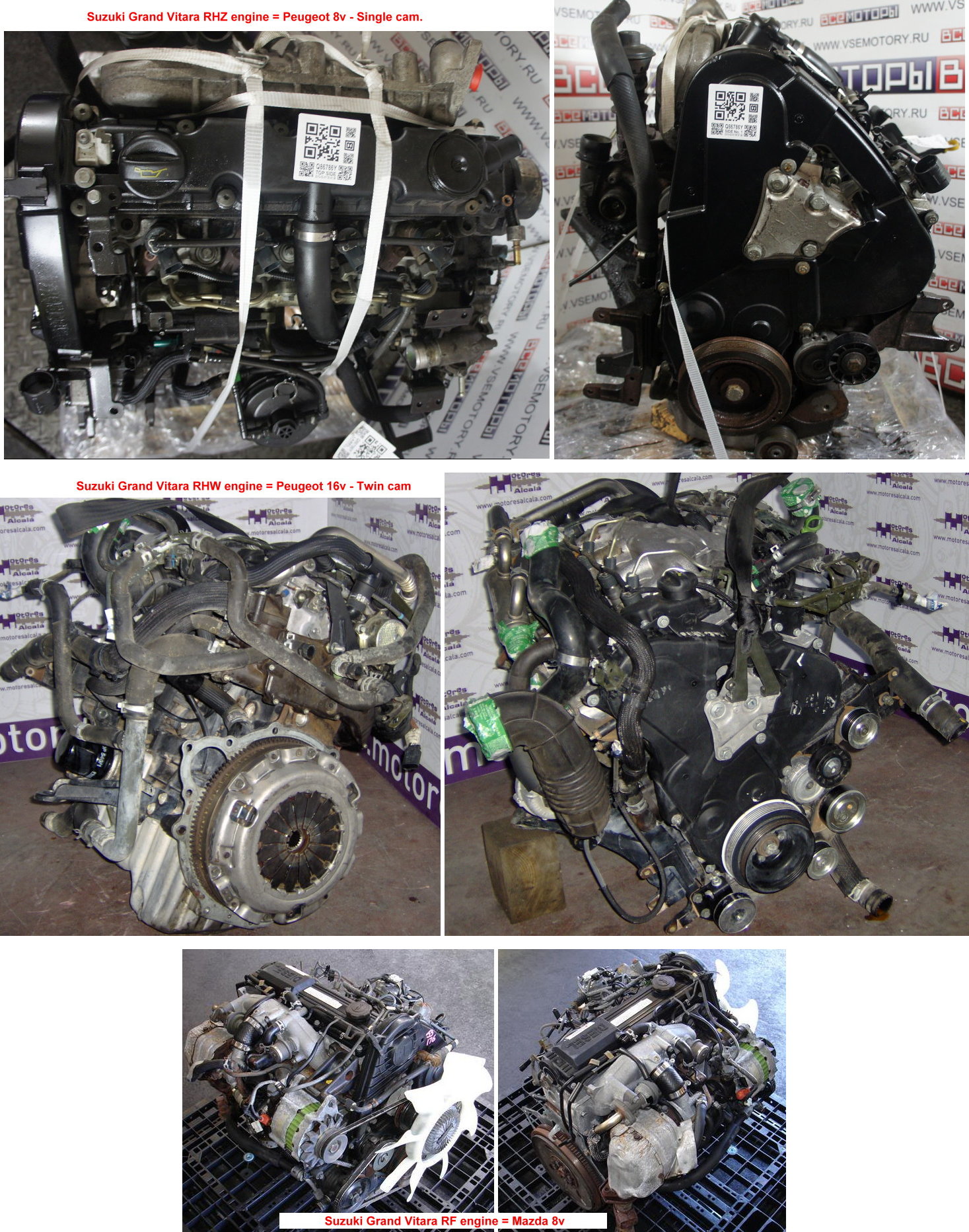

Post by Darrell » Mon Jul 20, 2015 10:42 pm
Just for reference ...
Grand Vitara 2L diesel engines .jpg (636.84 KiB) Viewed 12303 times
dougie212
Posts: 92
Joined: Sun Oct 13, 2013 7:14 pm
Post by dougie212 » Tue Jul 21, 2015 6:47 am
That's awesome, thank you very much Darrel. I'm sure when they say 'special tool', I can find an alternative not so special tool.... Thank you..!!
