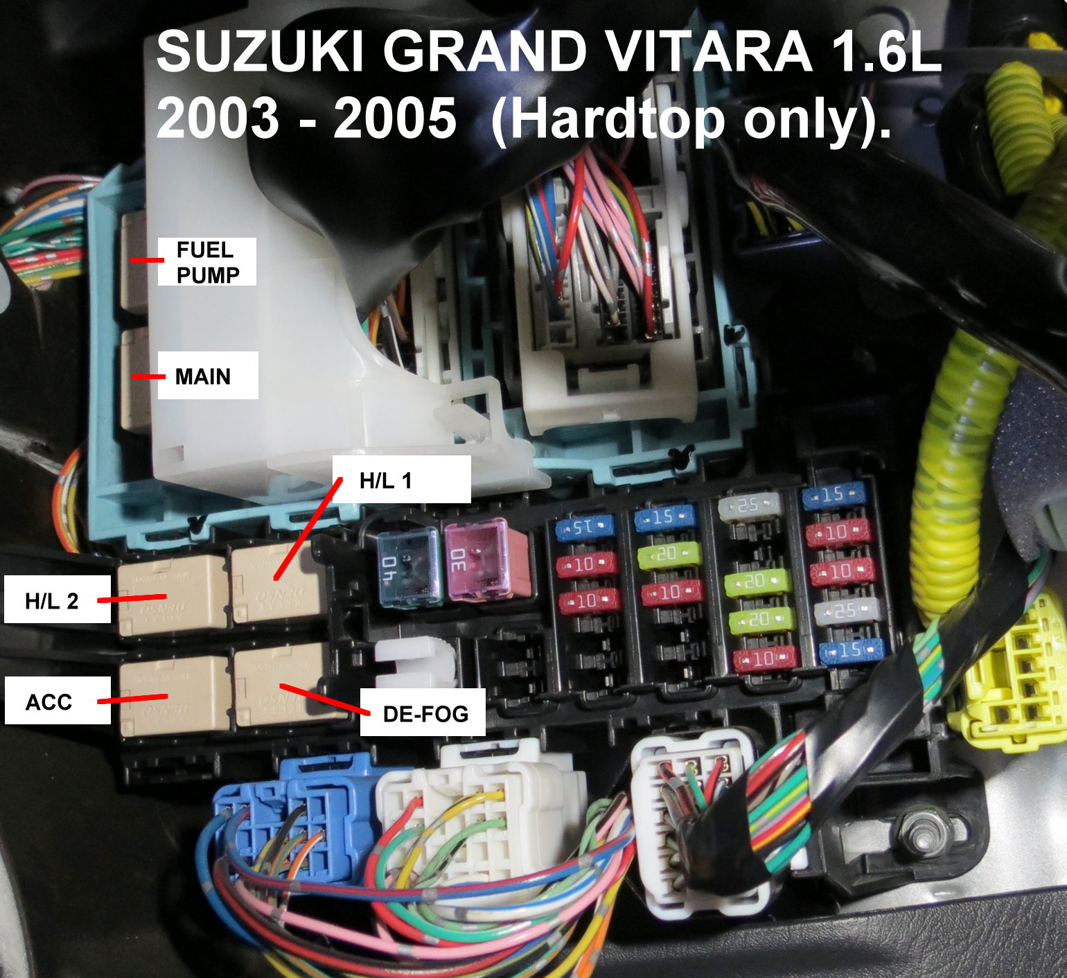

Blown fuse, for cig lighter/aux sockets. All fuses in engine bay intact (metered out), the owners handbook says there is a fuse box in the cabin on the drivers side. Has anyone changed fuses there?, and if so where is it ???... lol, Light going so cant check it out. "crap getting old and wearing glasses"

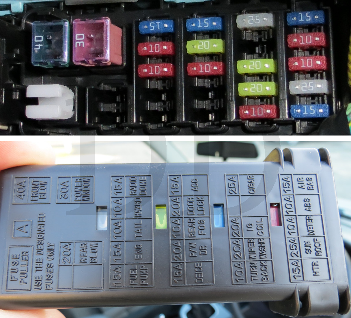

I believe yours should be the same as mine, right hand side under dash.
Grand Vitara Relays 2003 - 2005 .jpg (402.1 KiB) Viewed 4728 times
Grand Vitara 1600se 2005 internal fusebox.jpg (348.3 KiB) Viewed 4728 times

Thanks for that one Darrel, much appreciated. Fuse blew coz my phone charger was faulty?? won't make that mistake again.

Darrell, thanks, found it, fuse changed and all back to normal. Gotta say though, need to be a contortionist to get at the fuses, (or is that old age lol)
