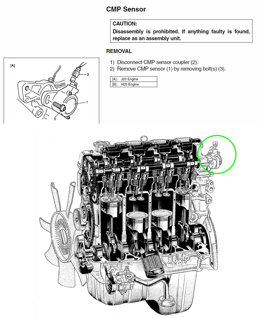

Re: Misfiring badly
We seem to have a difference of opinion here
, as far as I'm aware the camshaft sensor controls the ignition timing on the J20A engine. Either way this unit can suffer from heat-soak (fails when hot) and cause the symptoms you have. The only way to really test this unit is with an oscilloscope to check the wave pattern when the misfire happens. This is not very practical even if you have a scope. The crude method I have known used is when the misfire starts, stop the engine and cool the sensor with a wet rag for a few minutes and then start it back up and see if the misfire has gone (if only for a short while). If this cures it for short while it's most likely faulty. The black plastic part is actually the sensor. I like proper fault diagnostics but in this case it's not easy to do, chances are a multimeter test would say its OK. I guess it's your choice as a new sensor may not cure it and therefore be a waste of money. Best of luck
