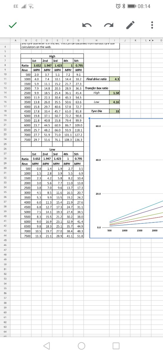

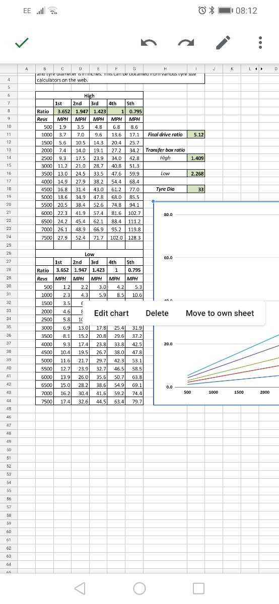

Re: Transfer box and diff ratio calculations for 33s
Iv just found the excel calculator in an old post but its showing different speeds to what you got. I thought i changed the ratios so they were all correct for a samurai. Bloody dark art this stuff
How different were the speeds? They shouldn't be any different as thats an old verion of the same sheet. Did you make sure 5th gear had the correct ratio as there are two different ratios available.
Also I always input ratios to 3 decimal places.
Just a couple of examples, im probably doing something wrong
I guess regardless of speeds, the 4.3 diffs and 1.58 high box is closest to standard with 33s. Thats in both our calculations.
