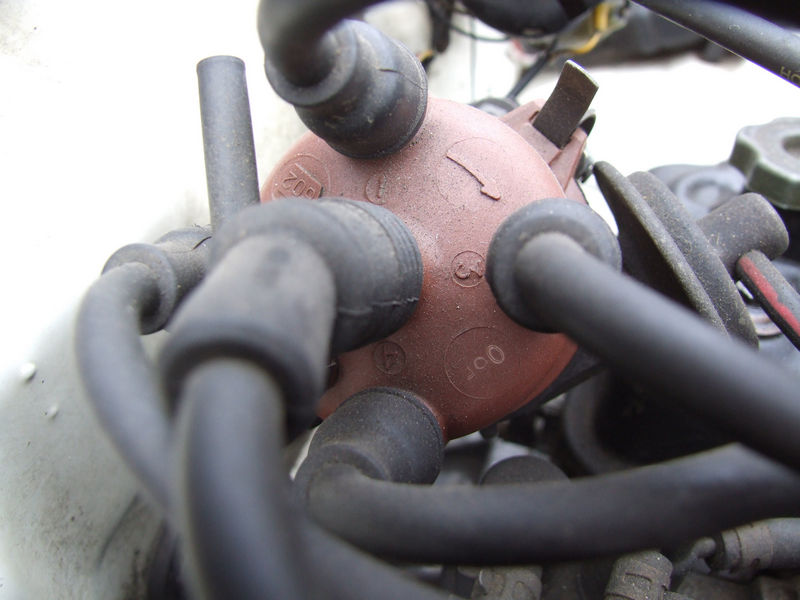

yeah.. im tired of this crap...
DIZZY cap.jpg (66.85 KiB) Viewed 8047 times

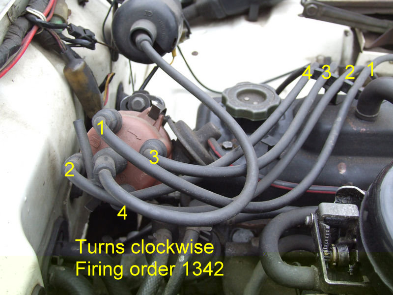

Re: mixed up my HT leads..
Post by Darrell » Mon Aug 29, 2011 2:22 pm
If you haven't set fire to it yet :D have a cup of tea then try this. Just took a picture of mine :thumbup:
