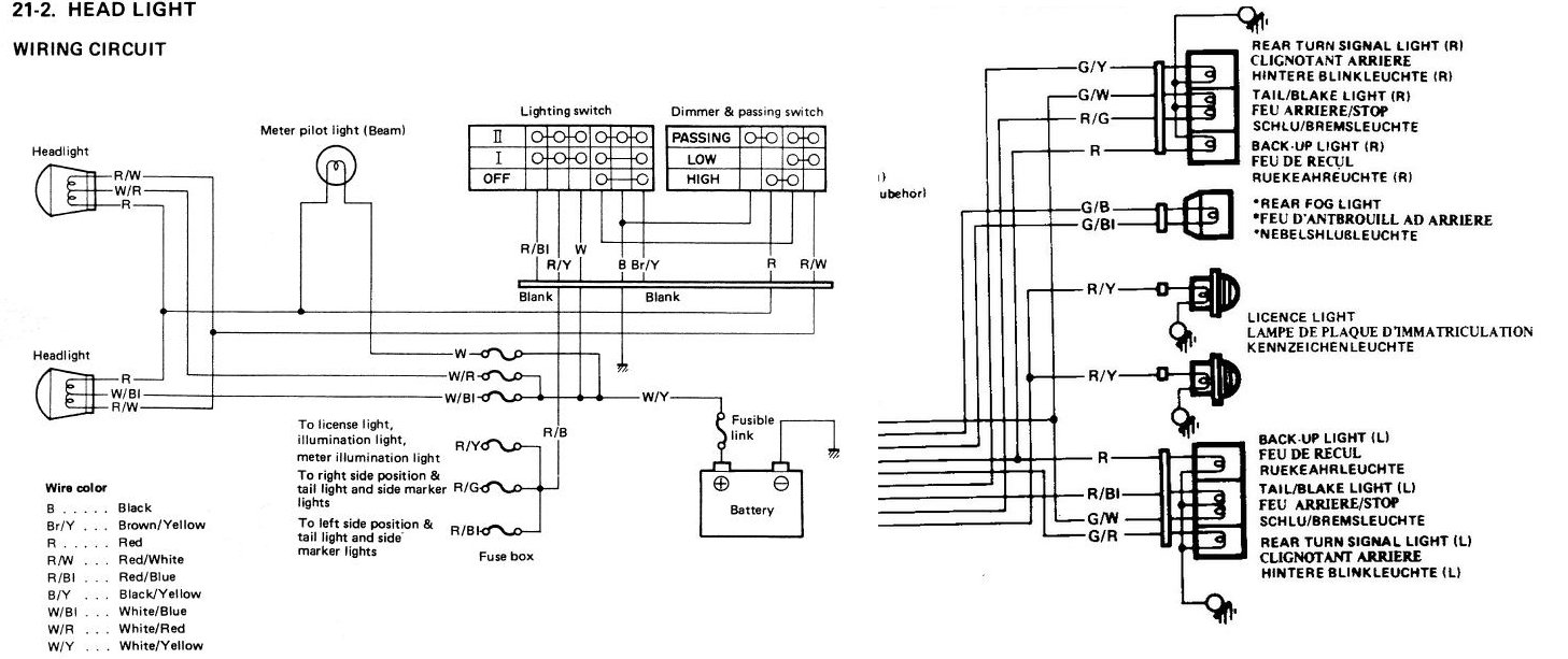

Plus has any body got a diagram of the religh by the fuse box

Re: side lights flashing when hazards on
Try any old piece of wire or a jump lead to connect your bumper earth to the body and see if this helps. I've got loads of diagrams if needed
These do
- Untitled - 1k.jpg (159.26 KiB) Viewed 6036 times
- indicator circuit.jpg (51.42 KiB) Viewed 6036 times
