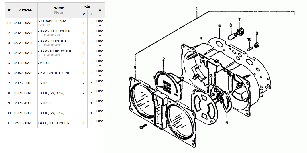

well i was thinking that the lights behind the clocks are very dull and just dont light them up at all so does anyone know what LED bulbs go in the 410 clocks? i know you can get LED replacements just need to know the type..

If you have these clocks, number 8's part number "Googled" came back as a T10 bulb.
I googled "T10 wide angle Led bulb" and found these. I can't guarantee there right though, just what I seached. You can get T10 with more led's on, but they may be too long to fit in ??
Click Here for Ebay Listing
410 clocks.png (82.61 KiB) Viewed 4883 times

do you know how many are in the cluster?

2 according to the diagram.
