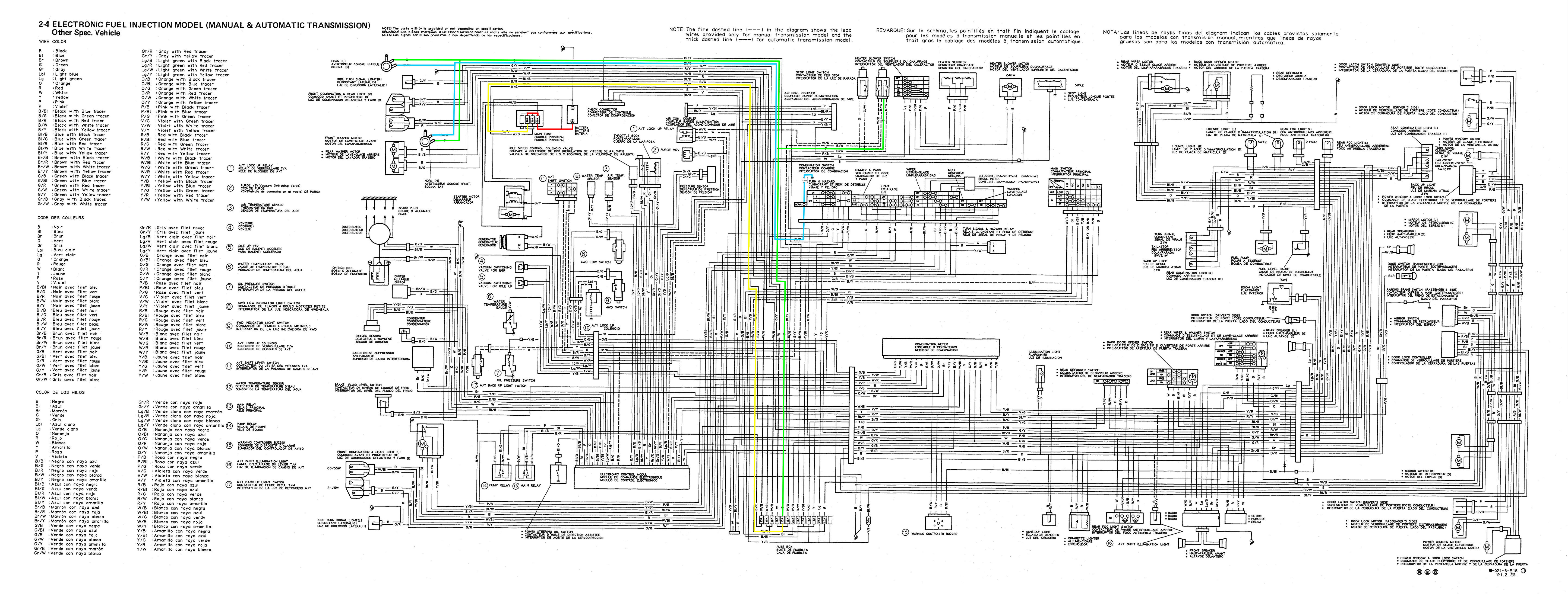

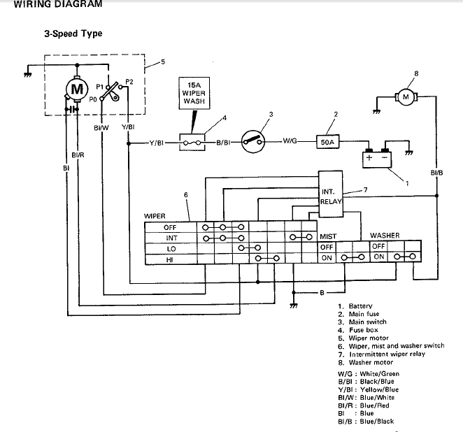

Well I can't work it out
The horn has 12v regardless of ignition switch position.
Its just earth's via the horn switch.
I suspect the wiper intermittent relay is at fault but have no diagram to let me know what's going on inside the relay.
The relay is part of the switch unit so is not replaceable other than swapping the whole unit.
Sorry I can't be more helpful

So it's not possible to fix the intermittent wiper setting unless I replace the whole switch unit? That's quite a difficult thing to do, isn't it? The wipers in any state don't stop at the bottom where they should, they stop wherever, haha. I guess this is part of the same issue.Darrell wrote:Well I can't work it out![]()
Sorry I can't be more helpful.
Re: Horn not working, intermittent wipers not working
Now you have said the wipers don't self park I'm going to say it's the switch within the motor playing up. This controls the self park and gives a signal to the intermittent relay. You can check this out if you have a multimeter.
