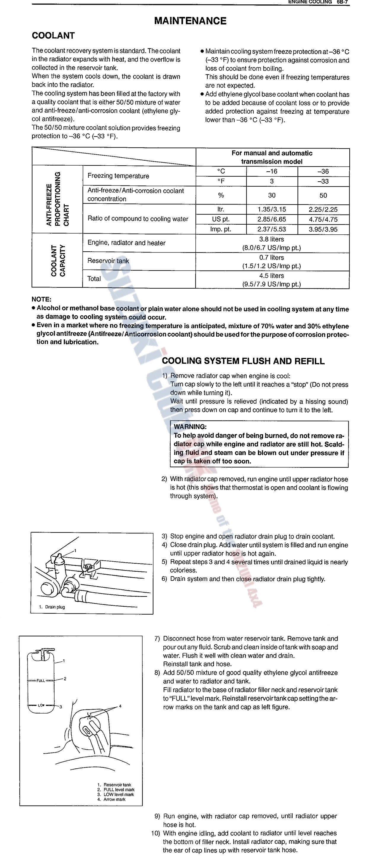

Hi group, I need to replace my coolant on a 2005 Jimny 1.3L petrol, does anyone know of any guides, or any tips for doing this without getting airlocks, and is the capacity 4.5L?

Robbed some pages from the manual and joined :salute:

That's brilliant, thank you kindly.

I'm not aware of any airlock problems :thumbup:

Job sorted, all good now thanks again.
