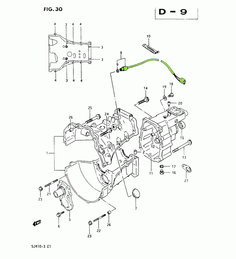

Re: Reversing light gearbox switch location?
Mines on the top about half way down the length of the unit.
You might be able to see it from the engine bay.

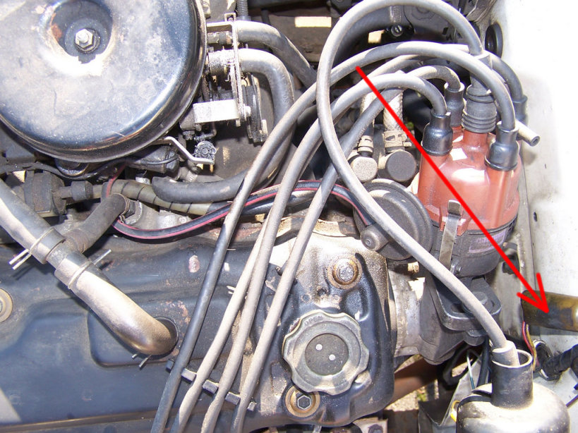

The fuse is shared with the indicators 10A.
The wires to the switch on the later type 410 are the same as the 413, Red and yellow.
On my 413 you can find the connector to the switch next to the coil.
Yellow is the supply.
The switch is here..

I couldn't wait! I went out armed with a torch, put ignition on, in reverse and wiggled the connection plug by the coil and hey presto, reverse lights came to life! Thanks again for the info
