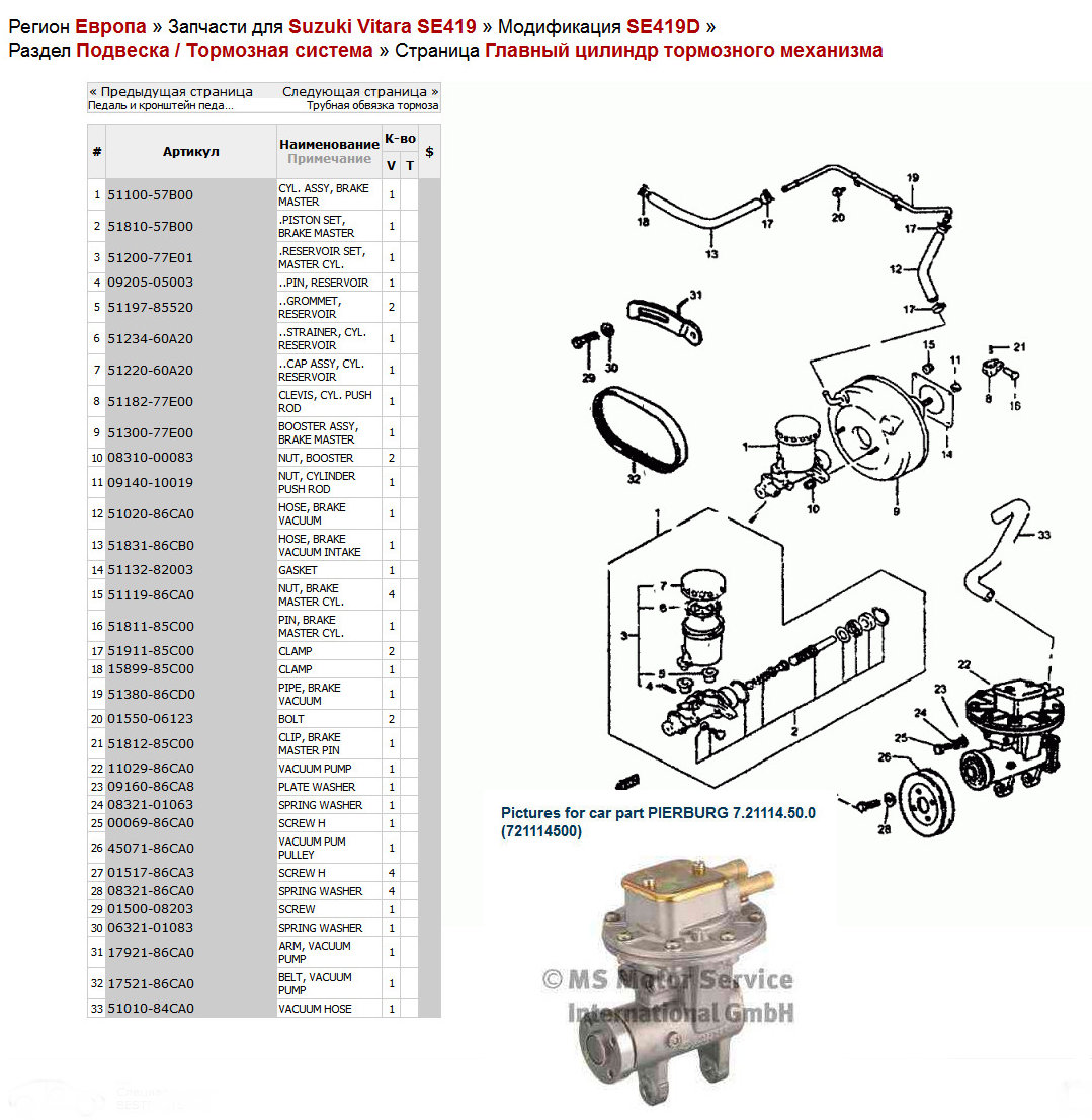

Post by Darrell » Mon Mar 03, 2014 8:39 pm
I assume they mean the vacuum pump needs replacing :er:
The one for the "Santana Samurai SJ419" is the same part number as for the Vitara SE419
Hope this is what your after, they aren't cheap :cry:
se419 diesel vacuum pump.jpeg (281.58 KiB) Viewed 4741 times

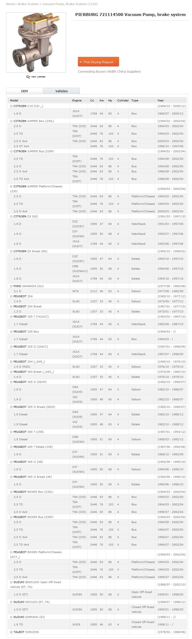

Re: Master Vac
Post by Darrell » Tue Mar 04, 2014 9:53 pm
They are fitted to quite a few different diesel vehicles.
I have noticed that the inlet/outlet pipe direction does alter though.
I would expect the cap to screw on whichever direction required but don't know for sure.
