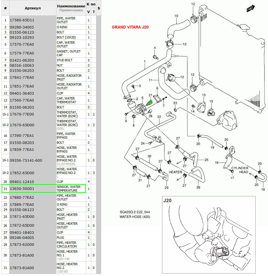

Can you advise where on the engine i will find the switch which controls the gauge.
I did see something right at the back of the engine by the firewall & hoping its not that one ?
Thanks.

Re: Fan Question
I'm afraid it looks like it.ipbr21054 wrote: I did see something right at the back of the engine by the firewall & hoping its not that one ?
Thanks.
- Grand Vitara J20 hoses.jpeg (245.07 KiB) Viewed 6316 times

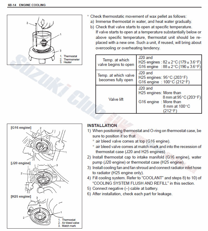

I hung the thermostat with cotton in a glass jug, boiled the kettle and filled the jug to the top.
Thermostat never even opened for the 5 minutes it was in the water.
I poured the boiling water away and took out the thermostat by hand as a test and boy was it hot.
I think with your help I have found the issue.
Tomorrow I will fit the thermostat, refill with anti-freeze and test.
Cheers.

Took note of the bleed valve position in the old stat.
The old stat was marked 82 degrees
